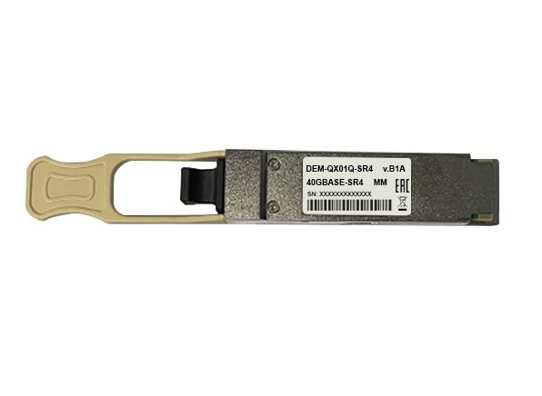

DEM-QX01Q-SR4
40GBase-SR4 Multi-mode OM3 (100 m) / OM4 (150 m) QSFP+ Transceiver

Transceiver Type
• QSFP+
Fiber Media support
• Multi-mode
Distance Capacity
• OM3 MMF: 100 m
• OM4 MMF: 150 m
Compliant Standard
• IEEE 802.3ba, 40GBase-SR4
Connector
• MPO (male)
Single/Bi Direction
• Single direction
Wavelength
• 850 nm
Output Optical Power (TX)
• Max.: 6.53 dBm
• Min.: -5 dBm
Input Optical Power (RX)
• Max.: 2.4 dBm
• Min.: -9.5 dBm
Sensitivity
• -9.5 dBm
Cable Type
• Single 1x12 MPO receptacle (female) with OM3 or OM4 MMF
Supported Features
• Hot Pluggable
• MSA Compliant
Physical Parameters
Power
• 3.3 V
Max. Input Current
• 600 mA
Min. Power Budget
• 4.5 dB
Max. Power Budget
• 9 dB
Dimensions
• 125 mm x 18.35 mm x 8.5 mm
Operating Temperature
• 0 to 85 °C
Storage Temperature
• -40 to 100 °C
Operating Humidity
• 30% ~ 70%
Storage Humidity
• 30% ~ 70%
