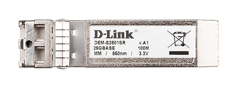

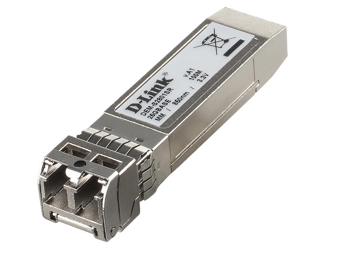

DEM-S2801SR/A1
Front view
View from the right
