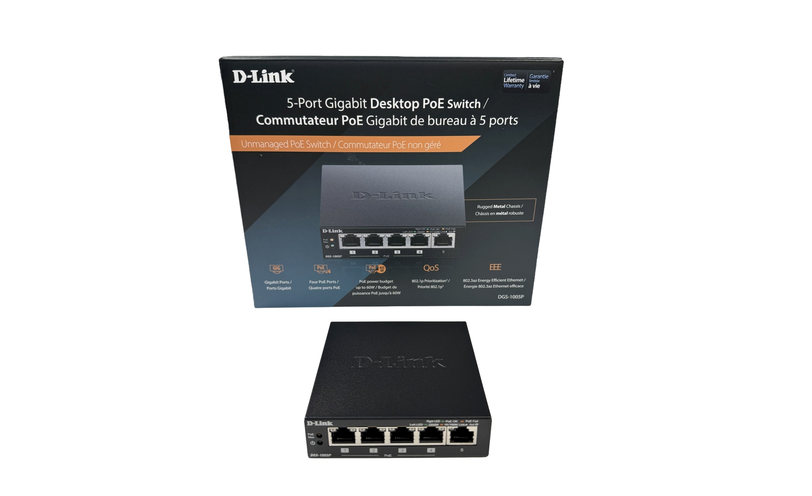

DGS-1005P
5-Port Gigabit Switch with 4 PoE Ports
Where to buy
Description
The D-Link DGS-1005P 5-Port Gigabit Switch with 4 PoE Ports enables you to connect Power over Ethernet (PoE) devices such as wireless access points (APs), IP cameras, and IP phones to the network. Built with home and small business users in mind, the DGS-1005P is compact and operates silently, making it ideal for most rooms and offices.
Power over Ethernet
The DGS-1005P features four 10/100/1000Base-T ports that support the IEEE 802.3af and IEEE 802.3at PoE protocols, supplying up to 30 W on each PoE port and providing a total power budget of 60 W. You can connect compatible devices to the DGS-1005P without using an additional power supply. This allows you to save on cabling and to install devices in locations without immediate access to power outlets.
High Performance
The DGS-1005P features plug-and-play installation and requires no configuration. Automatic MDI/MDI-X support on all ports removes the need for crossover cables when connecting to another switch or hub, and auto-negotiation on each port intelligently adjusts the port speed for compatibility with the connected device. With wire-speed filtering and store-and-forward switching, the DGS-1005P maximizes network performance while minimizing the transmission of bad network packets.
Green Technology
The DGS-1005P features green technology such as IEEE 802.3az Energy-Efficient Ethernet (EEE), link status detection, and cable length detection. EEE adjusts the power consumption of the switch based on network utilization, reducing the cost of ownership during periods of inactivity. Link status detection powers down ports when no links are detected, saving power when connected devices are shut down or disconnected. Cable length detection adjusts the power output of the port based on the cable length, reducing the power requirements of the switch.
Compact and Silent
The compact design of the DGS-1005P allows placement in most locations, including those where space is at a premium. The desktop form factor provides everything you need to set up a new network or expand an existing network, while the fanless design ensures silent operation even in noise-sensitive areas such as workstations and meeting rooms.

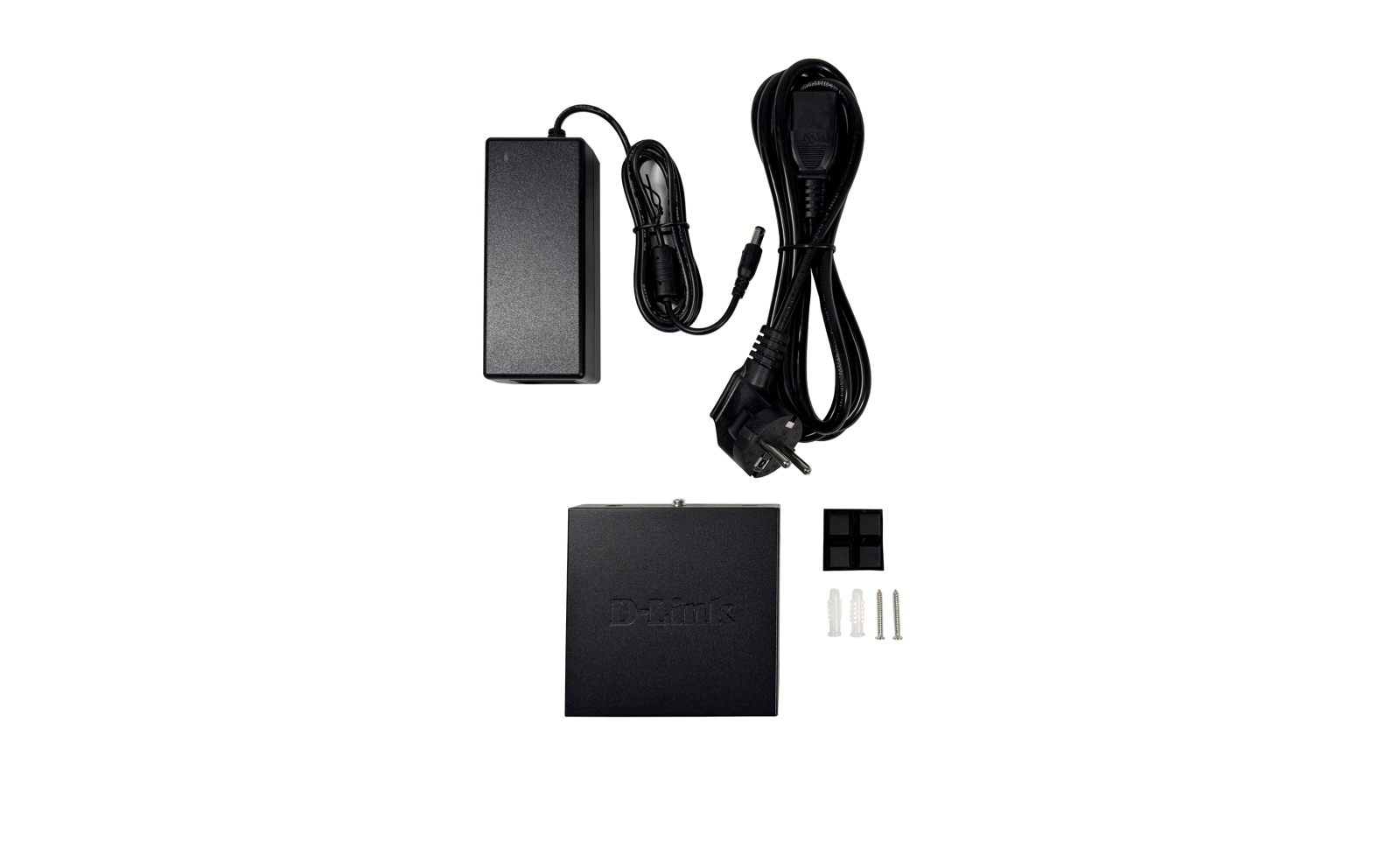

DC Input
• External 53.5 V / 1.2 A power adapter
