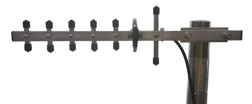

The ANT24-1201 outdoor directional antenna with 12 dBi gain operates in 2.4 - 2.5 GHz frequency band and has N Plug connector.
The ANT24-1201 antenna connects to a wireless device equipped with detachable external antennas, for example access point or router. Standard detachable antennas usually have lesser gain than the ANT24-1201, therefore using the 12 dBi ANT24-1201 antenna allows you to extend the 2.4 GHz wireless network coverage and improve the quality of signal reception/transmission. This antenna is designed for outdoor use. Wide range of operating temperatures (-40 to 80 В°C) allows you to use the antenna in harsh environmental conditions. N type connector provides compatibility with the most of outdoor access points, while the optional N Jack & RP-SMA Plug cable allows you to connect the ANT24-1201 to indoor wireless devices.
General features
Connector
• N Plug
Frequency band
• 2.4 GHz - 2.5 GHz
Gain
• 12 dBi
VSWR
• 1.5 : 1 Max.
Polarization
• Linear, vertical
HPBW / horizontal
• 70В° В± 5В°
HPBW / vertical
• 55В° В± 5В°
Impedance
• 50 Ohms
Power handling
• 50 W
Lightning protection
• DC Ground
Physical Parameters
Dimensions
• 370 x 97 x 45 mm
Weight
• 0.4 kg
Environmental Conditions
Survival wind speed
• 180 km/hr
Operating temperature
• -40 to 80 В°C
Operating humidity
• 100% @ 25 В°C
