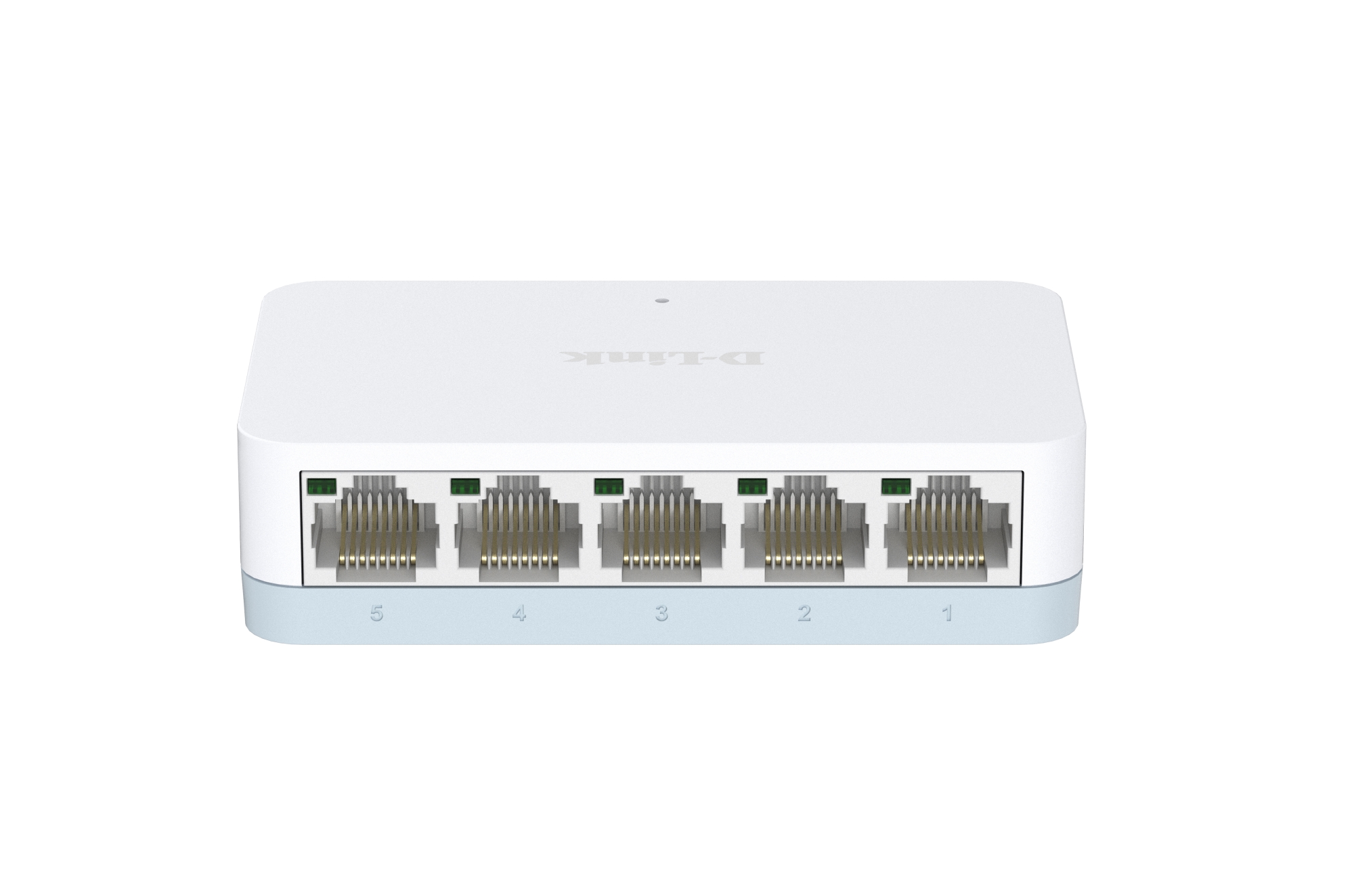

Interfaces
• 5 x 10/100Base-TX ports
Diagnostic LEDs
• Power
• Link/Act (per port)

• Speed and duplex mode auto-negotiation for each port
• Auto-MDI/MDIX adjustment on all ports

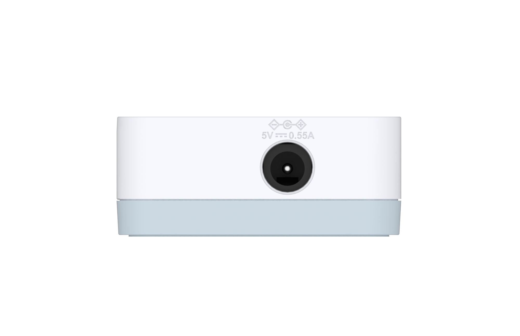

Power Input
• 5 V DC / 0.55 A external power adapter
