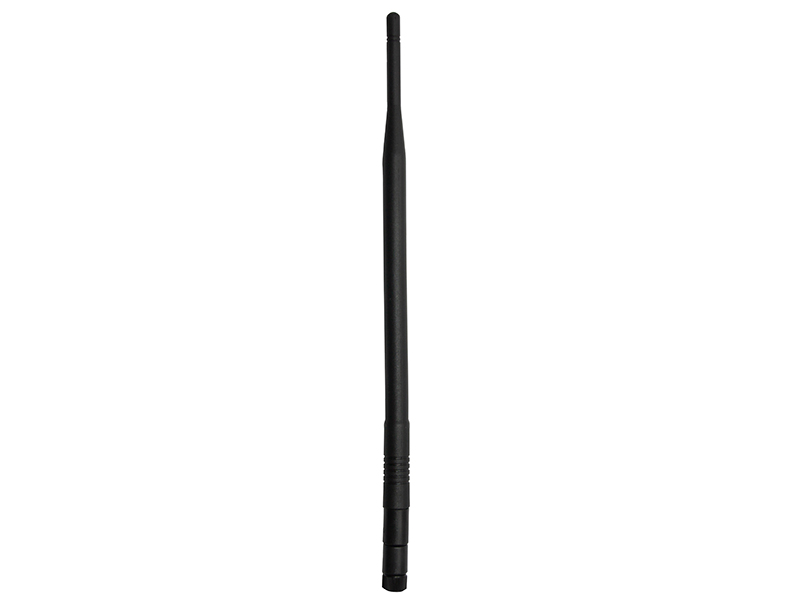

ANT24-0802C/B1
Front view

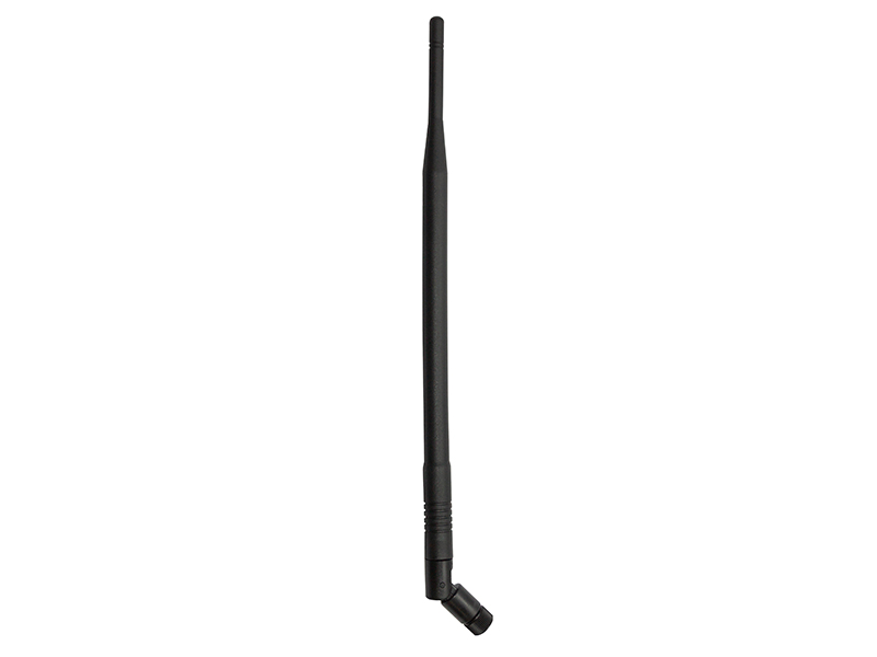

View from the right
