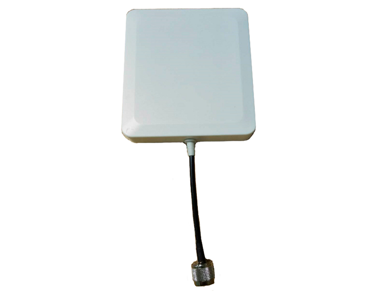

ANT24-0801  Outdoor Directional Antenna, 8 dBi
Pictures
ANT24-0801/B
Front view
