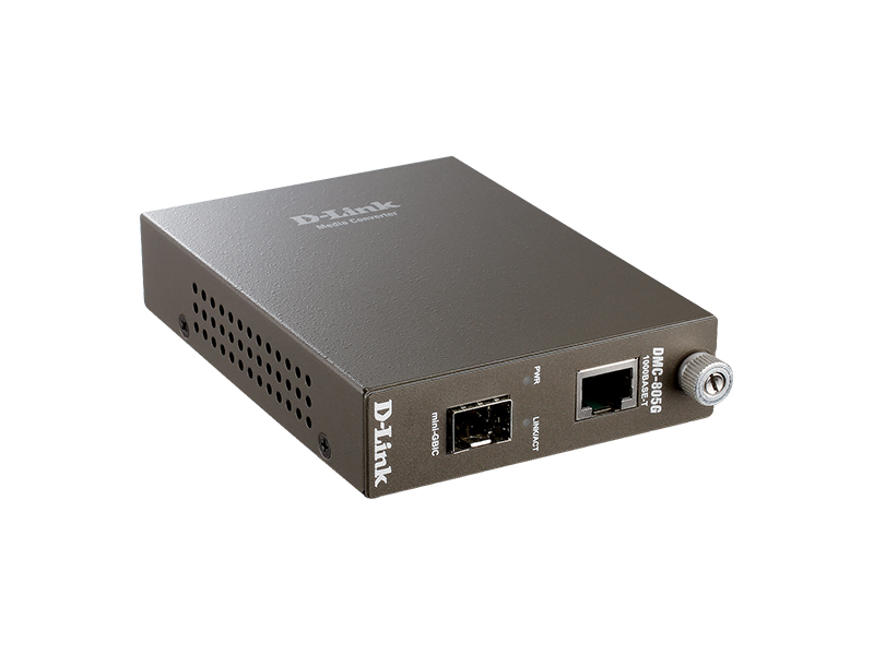

This converter converts 1000BASE-T twisted-pair signals to 1000BASE-SX/LX multi-mode/single-mode fiber signals. Maximum fiber cable distance is 550 m for 1000BASE-SX * and 20 km for 1000BASE-LX. 1 RJ-45 twisted-pair port and 1 SFP port (mini GBIC) are provided.

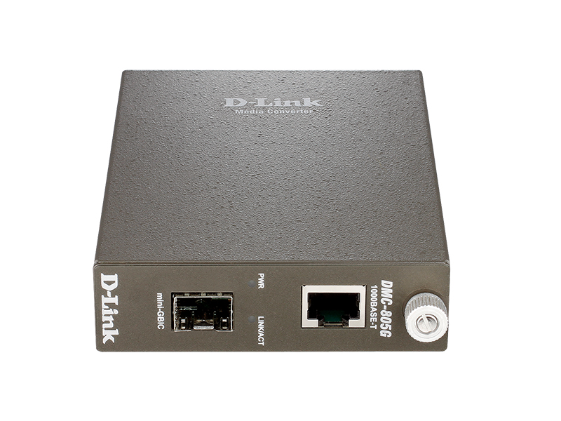

• 1 x 1000BASE-T RJ-45 port
• 1 x 1000BASE-SX/LX SC port

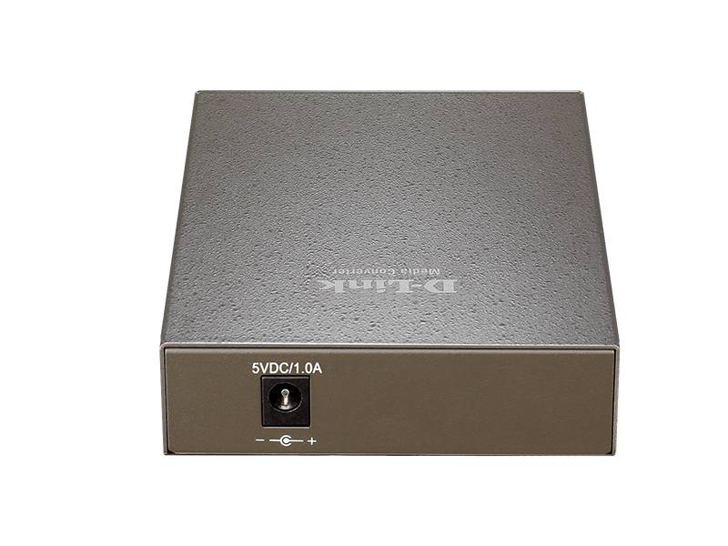

• 5 V/1 A external power adapter
