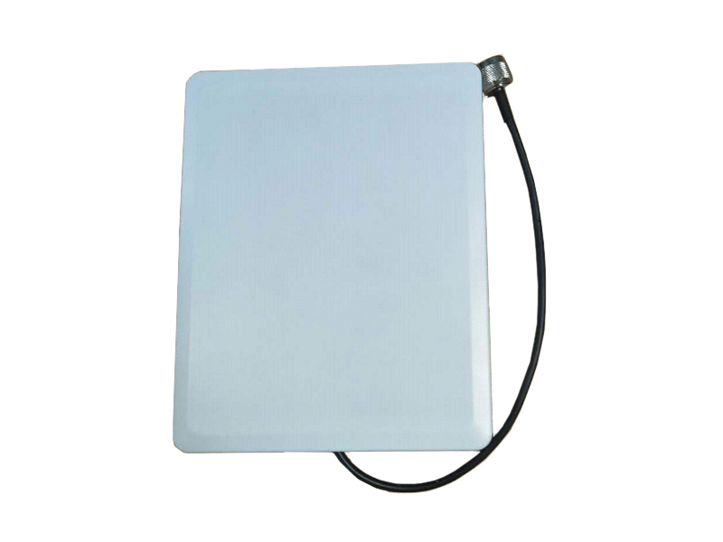

The ANT70-1800 outdoor directional antenna operates both in 2.4 GHz and 5 GHz frequency bands, has 14 dBi (2.4 GHz) / 18 dBi (5 GHz) gain and N Plug connector.
The ANT70-1800 antenna connects to a wireless device equipped with detachable external antennas, for example access point or router. Standard detachable antennas usually have lesser gain than the ANT70-1800, therefore using the 14/18 dBi ANT70-1800 antenna allows you to extend the 2.4 GHz or 5 GHz wireless network coverage and improve the quality of signal reception/transmission. This antenna is suitable both for outdoor and indoor use. Wide range of operating temperatures (-40 to 80 °C) allows you to use the antenna in harsh environmental conditions. N type connector provides compatibility with the most of outdoor access points, while the optional N Jack & RP-SMA Plug cable allows you to connect the ANT70-1800 to indoor wireless devices.
The ANT70-1800 is ideal for using with wireless devices in the Point-to-Point WDS/WDS+AP mode. Alternatively, Wireless Internet Service Provider (WISP) subscribers can also use this antenna to establish a strong connection between their host and their ISP’s outdoor access point.

ANT70-1800/Bx
Front view
