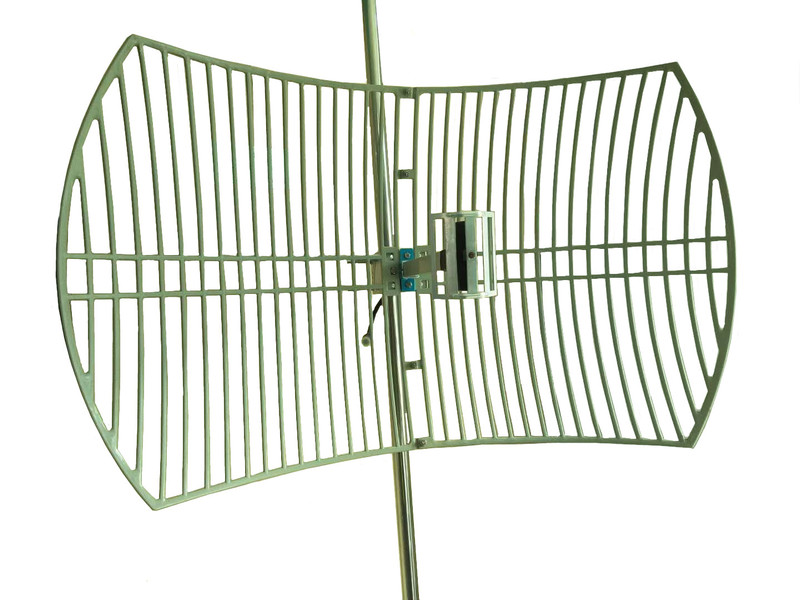

The ANT24-2100 outdoor directional antenna with 21 dBi gain operates in 2.4 - 2.5 GHz frequency band and has N Plug connector.
The ANT24-2100 antenna connects to a wireless device equipped with detachable external antennas, for example access point or router. Standard detachable antennas usually have lesser gain than the ANT24-2100, therefore using the 21 dBi ANT24-2100 antenna allows you to extend the 2.4 GHz wireless network coverage and improve the quality of signal reception/transmission. High gain allows you to build wireless bridges for long distances. This antenna is designed for outdoor use. Wide range of operating temperatures (-40 to 80 В°C) allows you to use the antenna in harsh environmental conditions. N type connector provides compatibility with the most of outdoor access points, while the optional N Jack & RP-SMA Plug cable allows you to connect the ANT24-2100 to indoor wireless devices.

ANT24-2100  Outdoor Directional Antenna, 21 dBi
Pictures
ANT24-2100/Cx
Front view
