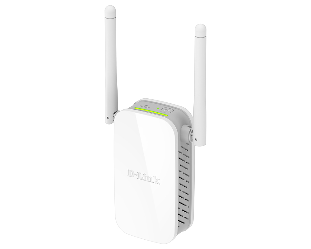

The wireless extender DAP-1325 is a portable device designed to increase the operational range of your wireless network. The extender supports operation with wireless devices of the standards 802.11b, 802.11g, and 802.11n (at the rate up to 300Mbps).
The device supports multiple functions for the wireless interface: several security standards (WEP, WPA/WPA2), MAC address filtering, different operation modes (repeater, client, access point), WMM.
WPS support allows connecting to the existing wireless network of a router or another access point and also allows adding wireless clients to the network of DAP-1325 by pressing the WPS button on the device.

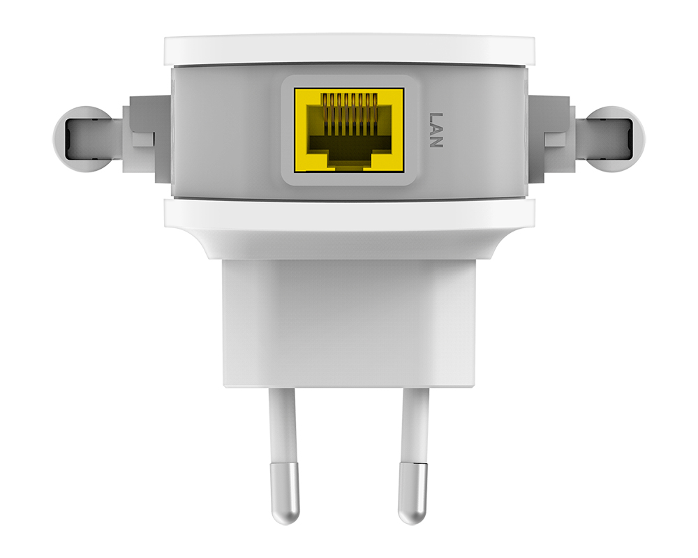

LAN Port
The wireless extender is equipped with one Fast Ethernet LAN port, which can be used to connect a wired client to the extender or to connect DAP-1325 to a wired router.
Signal Strength LED
The LED clearly shows the signal level of the wireless network to which DAP-1325 is connected. Due to this, you can easily find the best location for the extender.

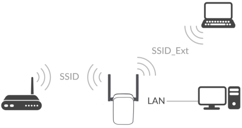

Repeater Mode
You can connect DAP-1325 in the repeater mode to a wireless router for extending the range of the existing wireless network.

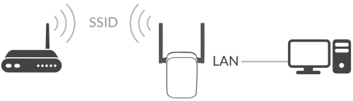

Client Mode
In the client mode, you can let a wired PC connected to DAP-1325 access the network of a wireless router.

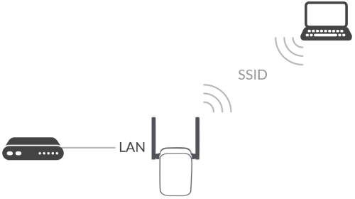

Access Point Mode
You can connect DAP-1325 in the access point mode to a wired router for adding a wireless network to the existing local network.
