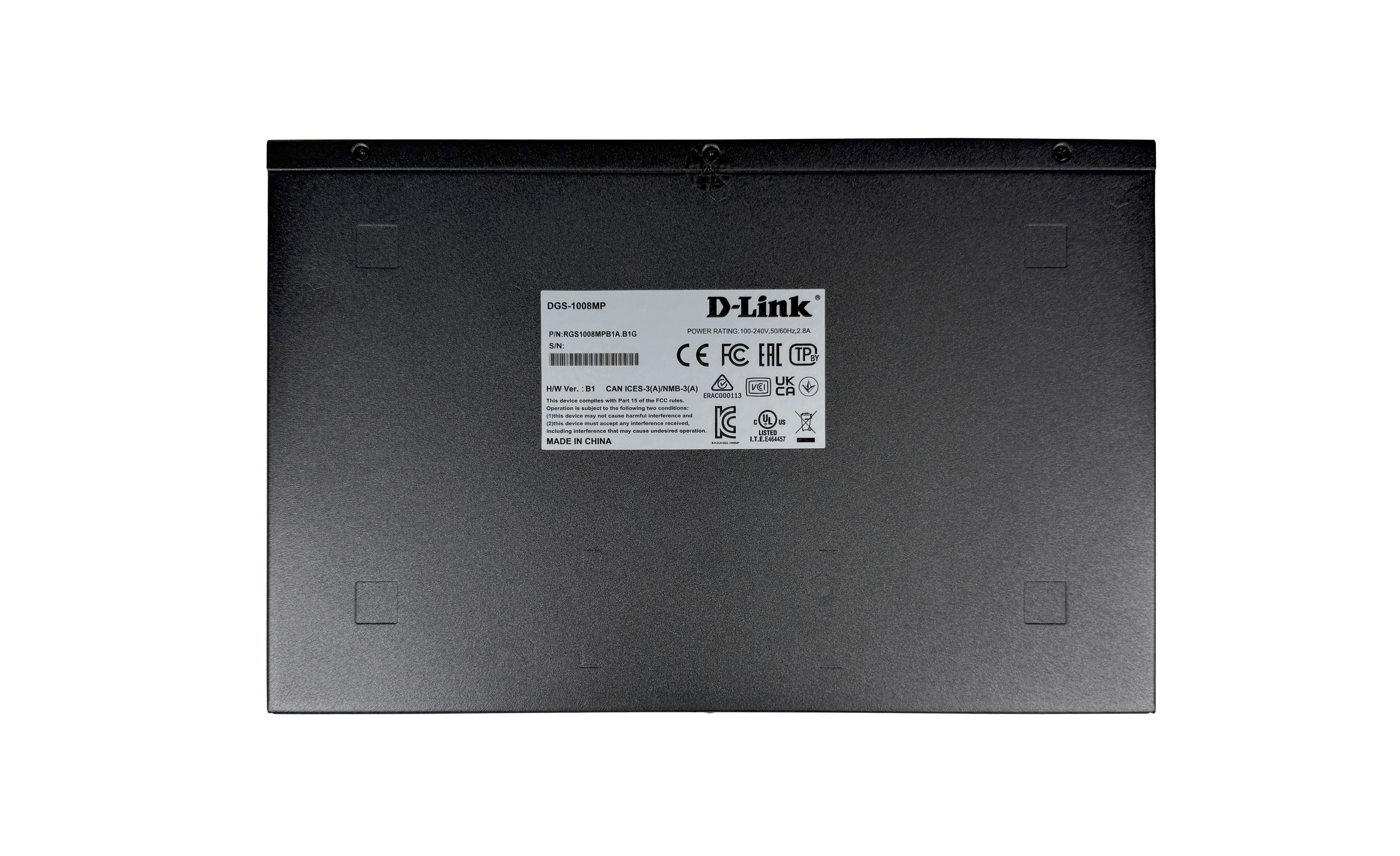

DGS-1008MP/B
Front view
View from the right
Back view
Bottom view
