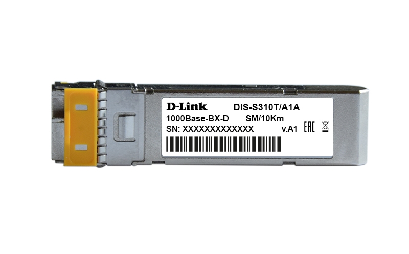

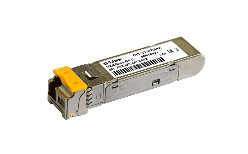

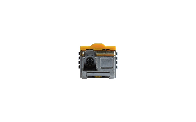

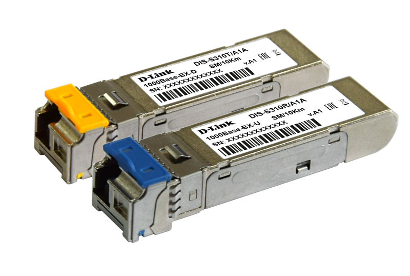

DIS-S310R/A
Front view
View from the right
View from the right
Top view
