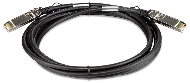

DEM CB300S is designed to support connections1 for 10 Gbps Gigabit Ethernet switches. The 10G Passive SFP+ Twinaxial Direct Attach Cable is equipped with SFP+ connectors,  and is suitable for the distances up to 3 meters.
Ideal for High-Bandwidth Operations
The D-Link 10G Passive SFP+ Twinaxial Direct Attach Cable supports speeds of up to 10Gbps, while having lower latency and power consumption than other cables types such as 10GBASE-CX4 and CAT6/CAT6A 10GBASE-T. This makes it an optimal solution for handling high bandwidth transmission within short distances such as inside energy-efficient data centers.
