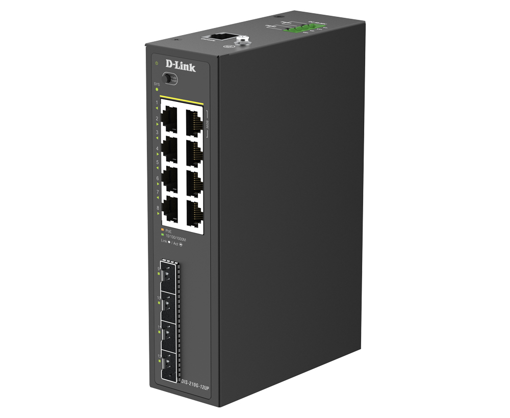

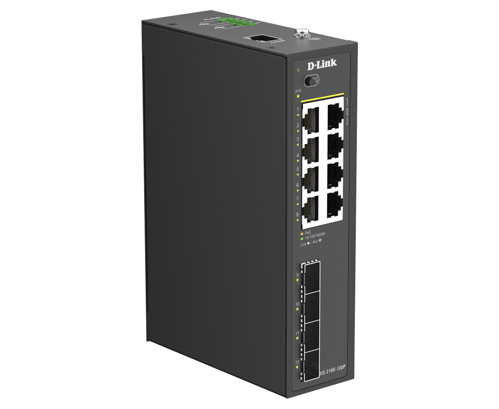

DIS-210G-12UPUus
Layer 2 Industrial Managed Switch with 6x10/100/1000Base-T 802.3at PoE Ports, 2x10/100/1000Base-T 802.3bt/UPoE Ports and 4x1000Base-X SFP Ports
Kirjeldus
The DIS-210G-12UP Layer 2 Gigabit Industrial Managed Switch is equipped with 6 30 W PoE-capable 10/100/1000Base-T ports, 2 60 W PoE-capable 10/100/1000BASE-T ports and 4 SFP ports. This switch features a robust design making it ideal for deployment in industrial and outdoor cabinet surveillance settings, capable of withstanding the harshest environments. The DIS-210G-12UP switch furthermore integrates advanced management and security functions to provide a complete industrial networking solution.
Durable, Reliable, and Efficient
The DIS-210G-12UP switch is housed in a highly resistant IP40-rated metal casing to protect it from harsh environmental conditions. The high electromagnetic compatibility (EMC) protects the DIS-210G-12UP from unwanted effects when operating in environments with strong electromagnetic interference. Meanwhile, the fanless design extends the life of the DIS-210G-12UP while also being able to operate in a wider temperature range of up to 75 °C. With DIN rail mounting capability, the DIS-210G-12UP can fit seamlessly into your industrial equipment infastructure.
Additionally, the DIS-210G-12UP features high-capacity 6 kV surge protection on all copper ports to help prevent damage to the switch and connected devices caused by sudden power surges and lightning strikes. The built-in surge protection of up to 6 kV can mitigate the damage to the switch from both indoor and outdoor devices and network connections by absorbing the excess energy while still letting through the amount of power required for the switch to operate normally. This increases network reliability, reduces repair costs, and removes the need for replacement hardware in the event of an electrical surge or lightning strike.

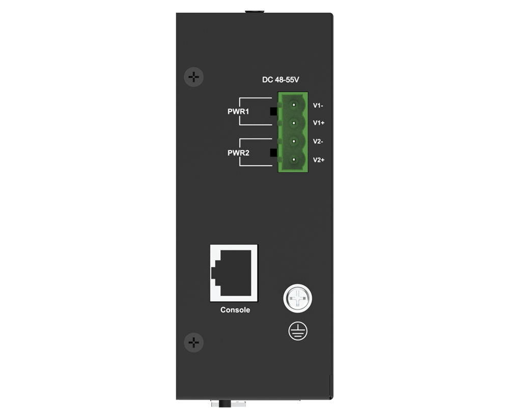

The DIS-210G-12UP supports ERPS quick failover recovery for ring topologies that ensures minimal downtime and avoids any loss of data in mission-critical deployment settings. Meanwhile, the dual power input allows for a redundant power supply to make sure the device continues to operate in the event of a primary power supply failure.

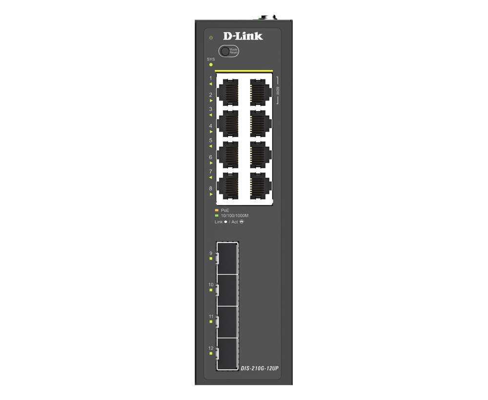

Number of Ports
• 8 10/100/1000Base-T PoE ports
• 4 1000Base-X SFP ports
• RJ-45 console port
Diagnostic LEDs
• Power
• SYS
• Link/Act (per port)
• PoE (per PoE port)

PoE Ports
• Ports 1 to 8
PoE Mode
• Ports 1 to 8: mode A
PoE Budget
• 240 W
• Up to 60 W per port 1-2
• Up to 30 W per port 3-8

Physical Parameters
Power Input
• 48-55 V DC / 5.2 A terminal block dual input

Pildid
DIS-210G-12UP/A1
Eestvaade
Paremvaade
Vasakvaade
Top view
